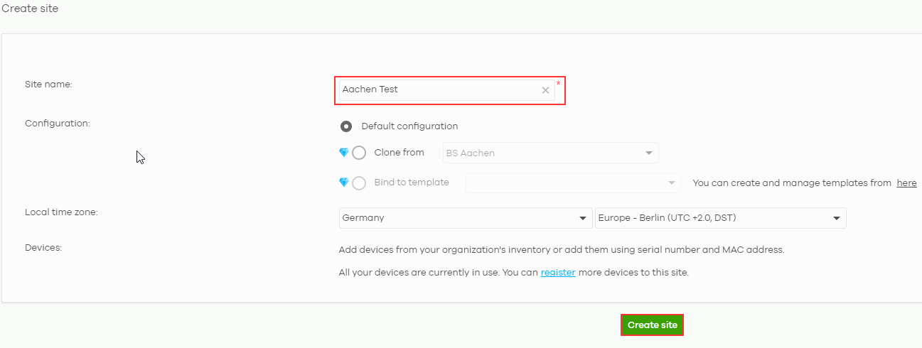

Site Creation:
If your organization is already created, and you need to create a new site or additional one, the steps below will help you do just that. After creating an organization, access the dashboard of your newly created organization.
  • Login to your Nebula account using your credentials. In the top bar, you will see a dropdown box labeled "Site:"
  • Look for the "Create Site" option and click on it.
Create new site menu
  • You will be asked to enter a name for your site. Pick a suitable name.
Site creation settings page
  • Upon entering the site name, click on the "Create site" button to complete the site creation process.
  • Your site is now set up, and you can start adding devices and customizing them to your preference.

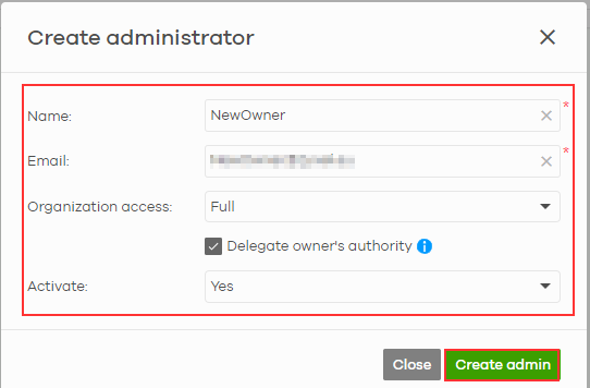

  • Back to migrating the organization, Log in to your Nebula account using your credentials
Go to Organization-wide > Administrators
Add administrator for ownership transfer
  • Click "Add" In the window that appears, fill in all fields as in the example below and click "Create admin" Make sure to have a second account set as Administrator and set the "Delegate Ownership" activated.
Change organization owner
  • To make the changes take effect click on the "Save" button

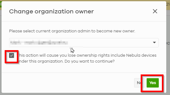

  • After that, you can change the ownership of an account using the new button "Change Owner":
Delete organization confirmation
You will then have to confirm your choice. To do this, check the "This action will cause you to lose ownership rights including Nebula devices under this organization. Do you want to continue?" box and click on the "YES" button
Note: The process will take a while, it will automatically reload the privilege when the task is done.
Change organization owner confirmation window
After that, you can see that the former Owner now only is an Administrator. If needed, feel free to delete the Administrator to make the new Owner the only account able to access the transferred Organization.

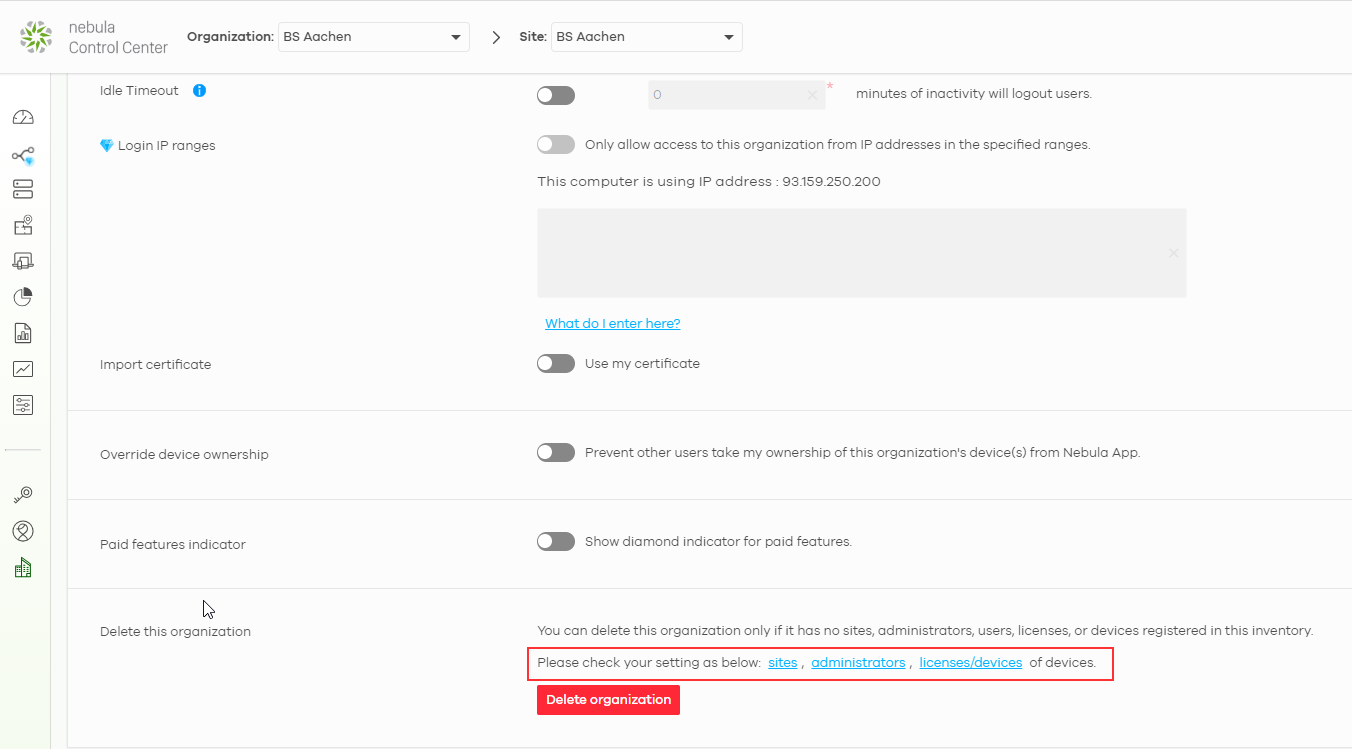

Deleting an Organization:
  • Go to "Organization-wide manage" -> "Organization settings"  and scroll down the page to Delete this organization.
Organization settings page with delete option
  • Click on the "Delete organization" button. After that, you will see a warning message "Deleting an organization cannot be undone! Are you sure you want to delete this organization?
Delete organization warning dialog
  • Click on the "Delete organization" button and after that, you will see a warning message "Deleting an organization cannot be undone! Are you sure you want to delete this organization?". If you are sure, check the Acknowledge checkbox and click the "Delete" button.
  • The organization and all associated sites will be deleted from Nebula.
What could go wrong?
  • Cannot delete organization - it still has administrators and sites.
Organization deletion error message
  • You can delete this organization only if it has no sites, administrators, users, licenses, or devices registered in this inventory. Please check your setting below: sites, administrators, licenses/devices of devices.
Organization settings showing remaining resources
