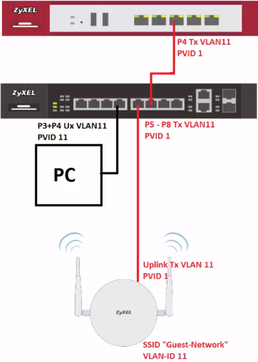

Here you can see a graphical topology. This article will focus on the configuration of the USG and set up a tagged VLAN interface on port 4:

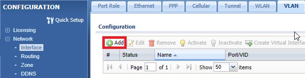

Navigate to:
Configuration > Network > Interface > VLAN
Click on the tab “VLAN” and click “Add”

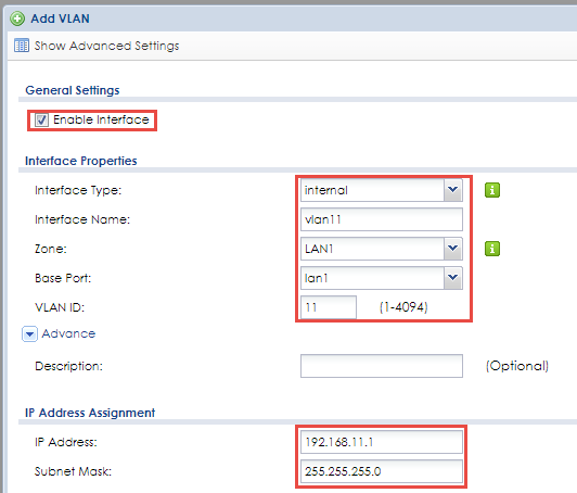

2. Configure your VLAN
As this VLAN interface will be in your LAN zone, please choose “Internal” as your “Interface Type”, choose a fitting “Interface Name” like “VLAN11”, choose a desired LAN zone and Base Port and type in “VLAN ID” 11 so that it matches with your “Interface Name”
Choose a desired “IP address” that is not conflicting with your already existing subnets

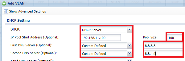

3. Setup a DHCP for your VLAN
You can set up a DHCP server if desired
2019-07-16_15_09_22-_zywall-usg-200___192.168.10.1_8443__-_.___Welcome_to_ZyWALL_USG_200___..png
After clicking “OK” the VLAN is set up. Packets with the VLAN tag 11 should now be forwarded from a connected switch.
