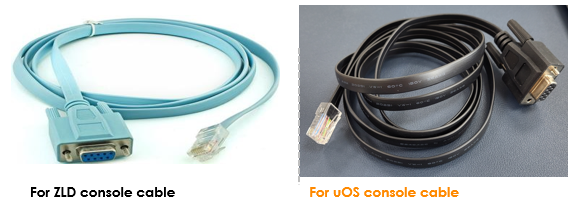

Hardware - Console Cable
To connect to the USH FLEX H Series with the new uOS operating system, we use the standard  RJ-45 to DB-9 Rollover Cable
[Change] - Use general console cable pinout, and it is not compatible with ATP/USG FLEX series. So if you have problems connecting to the Firewall using the console cable, please make sure you are using the correct cable.

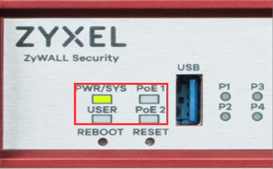

Hardware - LED Indication
PWR/SYS (Power/System) -Green on - Red
PoE (Power over Ethernet) - Green - Amber
USER  Event (User defined) - Green  - Amber - Green blinking
  • Green on  (Admin login)
  • Amber on  (User lockout)
  • Green blinking (License expired, Firmware available)

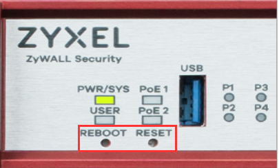

Hardware - Button Behavior
REBOOT - Press to reboot the device
RESET - Press more than 7 seconds to reset to system default. Press more than 30 seconds to return to factory default.
Please note:  that all settings will be deleted so a systematic backup of the configuration will help to avoid loss.
